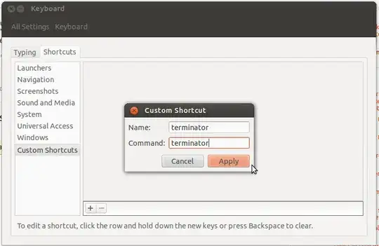

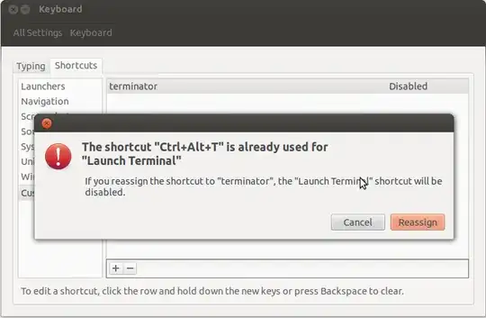

To change the shortcut and not default termainal,
  1. search for keyboard
  2. go to shortcuts and custom shortcuts
  3. press the plus sign to add new shortcut (in this case terminator)
  4. when told that the shortcut ctrl+alt+t is already in use press "reasign"
search for keyboard add new shortcut reasign
