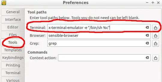

In its Edit → Preferences dialog, Geany has a Tools tab. (This is separate from the Terminal tab.) One of the utility selections that you can configure from the Tools tab is Terminal.
screenshot showing Terminal selection in the Tools tab of the Preferences dialog in Geany
It has this as its default value, but you can change it to whatever you like:
x-terminal-emulator -e "/bin/sh %c"
So one way to make it use Konsole instead of whatever x-terminal-emulator is configured to run is to replace x-terminal-emulator with konsole. (Don't capitalize the k.) That is, one solution is to change that command to this one:
konsole -e "/bin/sh %c"
Geany itself substitutes for %c when it actually launches a terminal emulator. Whatever terminal emulator it calls does have to support a -e flag--or you can change that commmand accordingly if it doesn't. (Specifically what to write instead would depend on whatever syntax it did accept.) But most terminals do, and this includes Konsole.
