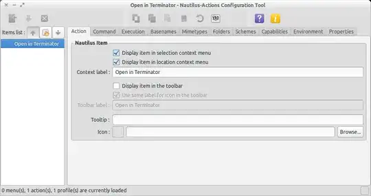

    • In the Actions tab, tick both boxes and select an appropriate name (e.g. Open in Terminator):
      Action (tab)

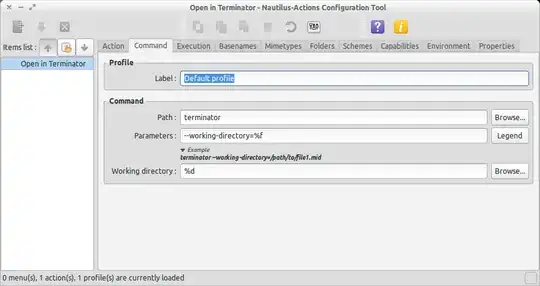

    • In the Command tab, set:
      • Path: terminator
      • Parameters: --working-directory=%f
      Command (tab)

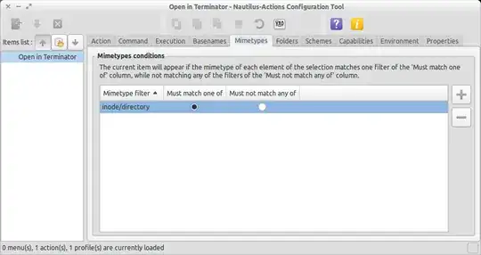

    • In the Mimetypes tab, set:
      • Mimetype filter: inode/directory
    Mimetypes (tab)

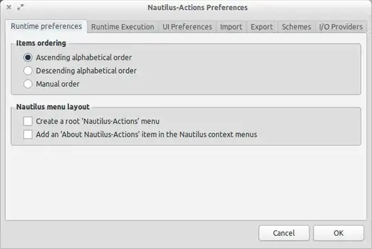

  3. I recommend that you also change the preferences in Nautious-Actions Configuration Tool to get rid of the two level context menu by unticking the following in Edit > Preferences:
    • (untick) Create a root 'Nautilus-Actions' menu
    • (untick) Add an 'About Nautious-Actions' item in the Nautilus context menus
    Preferences
