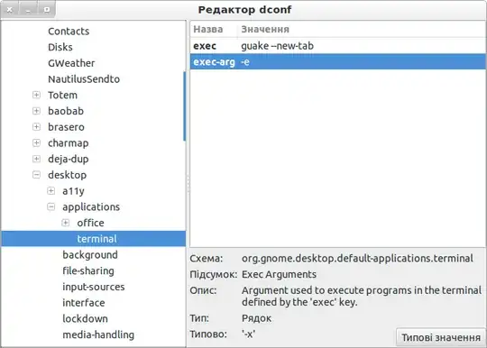

You could probably enjoy running gconf-editor — or maybe even dconf-editor since 12.04, — and navigate directly to the org.gnome.desktop.default-applications.terminal key:
dconf screenshot
The exec-arg parameter must be changed to Guake's -e. For the lazy:
gsettings set org.gnome.desktop.default-applications.terminal exec 'guake --new-tab'
gsettings set org.gnome.desktop.default-applications.terminal exec-arg '-e'
