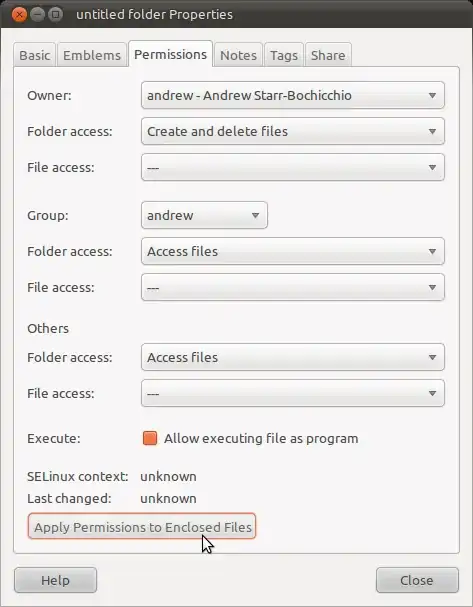

If you prefer, this can be done with a GUI as well. You will need to open Nautilus as root to do so. Press Alt + F2 to access the "Run Applications" dialog and enter gksu nautilus
Next, browse to and right click on the folder you would like to modify. Then, select "Properties" from the context menu. You can now select the user or group that you would like to be the "Owner" of the folder as well as the permissions you would like to grant them. Finally, press "Apply Permissions to Enclosed Files" to apply the changes recursively.
Though it seems this does not always work for some operations in a deep folder tree. If it does not work use the appropriate terminal command.
