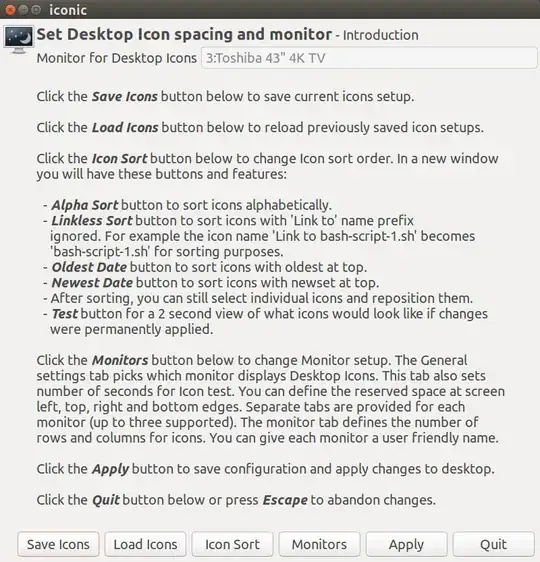

I wrote iconic and it lets you save and restore icon positions. Basically after a new user logs in have it restore saved icons. You will need to "tweak the script" to have it run during login. Additionally it will:
  • Allow you to move icons to any of three monitors
  • Not suffer the "lost icon syndrome" that occurs when monitors of multiple resolutions are used
  • Sort icons alphabetically, alphabetically with "Link to" prefix ignored, sort by modified date ascending or date descending
  • Allow different grid size (columns x rows) depending on monitor, EG more on 4K monitor than 2K monitor
  • Instant Test button for quick experimentation on column x row changes or reserved space changes for monitor left, top, right or bottom areas
  • Test button will last for x seconds defined by you, clear all windows before test and restore them after test
  • Bash script for easy modifications
You can get the script on github.
Here's the main screen:
Visit the github page for iconic to see all the other screens, explanations and a copy of the script.
