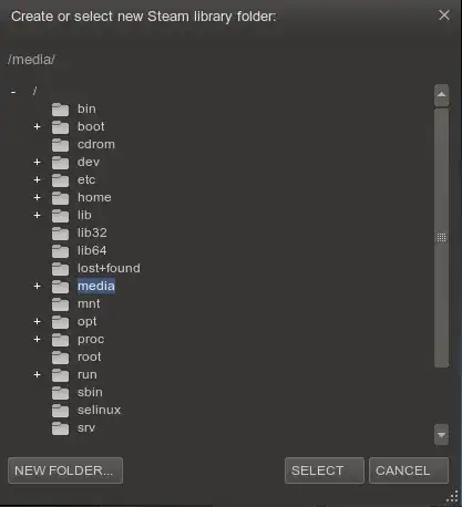

When you click on a game to install it on the first window that pops up there will be a drop down menu. On here you have a choice to install on the default directory or to create a new library.
Install dialog
When you choose to install in a new directory you will get a choice of where to install.
Choose a directory
I hope this helps.

  1. Go to the "Steam" menu and select "Settings"
  2. Click "Downloads" on the left and press the "Steam Library Folders" button
  3. Press the "Add Library Folder" button and select a new directory
  4. Right click on the new entry and select "Make Default Folder" from the context menu
All new installations will default to the new location.
