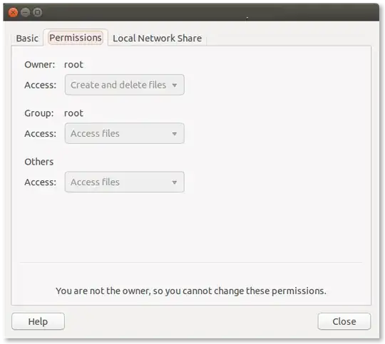

You go do this all through terminal, but I personally find it easiest to run my file manager (I use nemo but nautilus is default) as root and to change permissions graphically.
So open up a terminal and run gksudo nautilus.
Open the properties like you did in the screenshot. Since you're root now, you will be able to change it to your user.

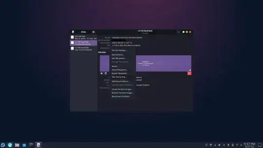

You can now use Gnome-Disk (sudo apt install gnome-disk) on Ubuntu or (sudo dnf install gnome-disk) if you are on fedora to take ownership and edit /etc/fstab via a GUI with no terminal commands.
Screenshot of Gnome-Disk on Desktop
