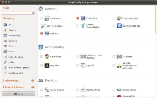

Compiz should work by default, you may just need to install a few extra packages:
sudo apt-get install compiz-plugins* compizconfig-settings-manager
The you can search for 'compiz' in dash, then you can open 'CompizConfig Settings Manager', and use it to change the settings to what you like CCSM
see also this question.

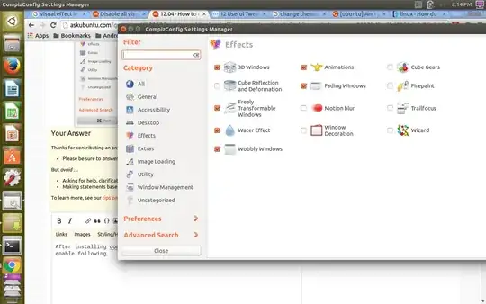

After installing compiz-plugins* compizconfig-settings-manager, please enable following wobbly windows option in effect section. you will get that animation.
