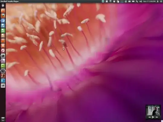

First restart your system (if you have not already done so) to ensure that the fglrx driver is loaded (before you attempt to run Compiz). When you log in, You should see something similar to this:
Unity Unity Desktop. Ignore the customization, and the album cover artwork on my Desktop :)
If you do not see this, then it means than Compiz is likely crashing. If you get a message saying that you cannot run Unity, then you have an issue with your drivers.
