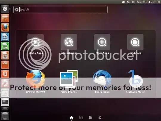

When I open the Unity Dash from the launcher, the Dash takes up the whole screen and doesn't give me the ability to resize it. This makes it impossible to see my desktop and drag and drop icons to it in order to create shortcuts. I've seen some screen where the dash has maximize and minimize buttons, but I do not have anything like that on my 11.10 install.

When opening the Ubuntu Dash, you should see three "window buttons" in the upper-left. Click the maximize button (the square) to switch between fullscreen and windowed mode.

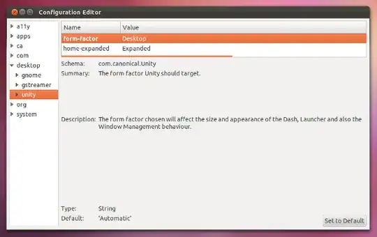

Install and launch Dconf Editor (Software Center). Once it's open, navigate to the desktop > unity section in the left pane. You will see a form-factor option, which if set to 'Netbook' will made the Dash fullscreen, and if set to 'Desktop' will make the Dash windowed.
picture of dconf

You can install dconf-editor from Software Center start it, and go to
desktop -> unity
and change the form-factor from Netbook to Desktop.
