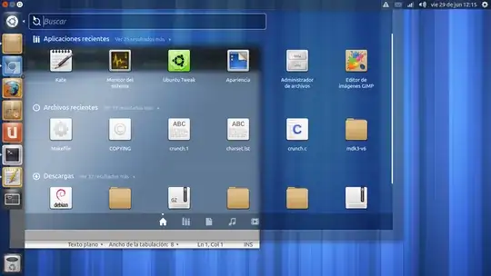

Unity 3D: ... O.O THAT WAS TOTALLY UNESPECTED, I logged in in Gnome Desktop with my docky at my left side, I was surfing in Internet, when wild messages appear, first a Metacity Error, ok, then pops up a compiz error, hmmm ok, but then Unity 3D appeared at my left and I was shocked 0.0 because supposedly my Video Chip (MoBo integrated Via Chrome9) is not compatible with Unity 3D for some reason, It demonstrates it isn't imposible but I think there might be a lack of interest about getting Unity 3D working in every video chip. I'd really like to know how was that posible.
I'm pretty sure I'm using Unity 3D because launcher didn't change color after changing background, besides it has some transparency, the "light" in icons is like the one I saw in some post right here, but there is something weird because when it happened Icons in Unity blurred when I opened Dash, but now they don't blur.
