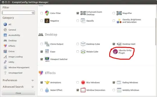

You'll need the CompizConfig Settings Manager (which you can install via the Software Center).

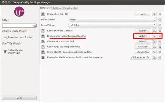

Once open, click on Ubuntu Unity Plugin (in the Desktop section). Under the Behavior tab, you'll see Key to put keyboard-focus on launcher. Simply change the keybinding there.
Note that in later versions of the Unity plugin, the tabs in that plugin have changed (as the comment below by Carlton mentions). The Key to put keyboard-focus on launcher stting is now under the Launcher tab.
