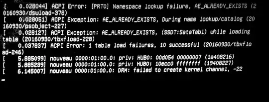

The problem occurred here: a black screen appeared saying that there is an ACPI Error. The error says:
[0.028044] ACPI Error: [PRTO] Namespace lookup failure, AE_ALREADY_EXISTS
and other lines that explain the error.
After this error screen, the normal Ubuntu boot screen appears (the Ubuntu written above the five dots), but after a while it freezes, forcing me to manually switch off the PC. The BIOS is updated. I think that during the repair, the Asus technicians deleted Ubuntu in some wrong way, leaving something in the hard drive that's now compromising reinstallation.

I have solved. I recommend you don't use UNetbootin to create the bootable USB; instead use Rufus if you are in Windows or use the command line if you are in Linux (dd command). The main problem was with the graphics drivers and these are the steps I followed to solve this issue:
  1. Once you have launched the bootable USB and you see the GRUB menu, move the selector to Try Ubuntu or Boot from live disk, whichever option comes.
  2. Press E in order to edit the install command you are about to run. Go to the line that starts with word linux (the one with the words quiet splash), go to the end of this line and after the --- put the following words: nouveau.setmode=0.
  3. Press f10 to boot the system
  4. You can now run the installer
  5. After reboot, repeat steps 2 and 3
  6. Once you have booted go to terminal and type
    sudo apt-get install nvidia-384
    (384 is the latest and more stable driver version at the moment, replace this number with the last driver version you find on nvidia site in the future).
  7. Now from menu go to Additional Drivers, go to proprietary drivers tab, select nvidia drivers and reboot
