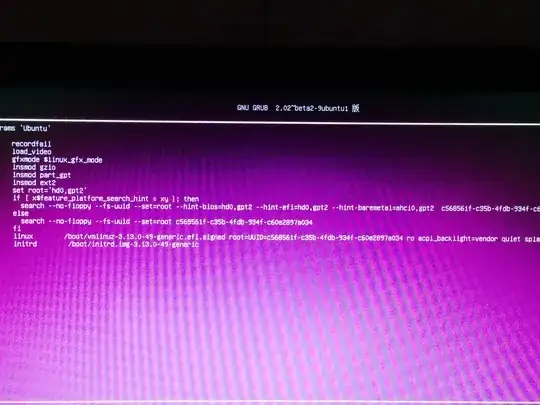

I installed Ubuntu 14.04 in hard disk.
then after I did update-grub
sudo grub-install /dev/sda
sudo update-grub

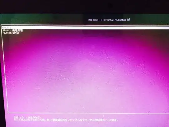

After restarting Ubuntu 14.04, grub menu loaded with ubuntu,ubuntu advance,system setup.
When I choose ubuntu option, it seems that ubuntu can not start, does something wrong with grub2? here are the some screenshots. since i don't have enough reputation to post picture,please click the url below to see the issue screenshot,thanks a lot/
enter image description here enter image description herethis is the screenshot,when i edit ubuntu option
