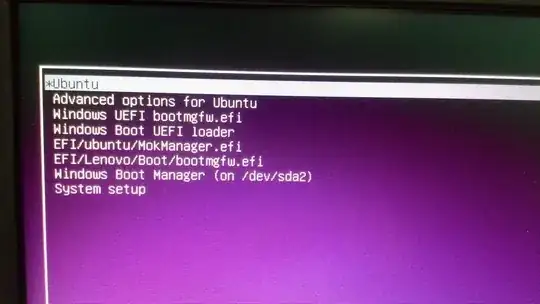

I got a computer with Windows 10. After installing Ubuntu along Windows 10 and fixing the boot sector with boot-repair, I ended up with this for the 1st time:
grub menu
It does work when I choose the 1st or 2nd last ones. But how to delete all those redundant items?

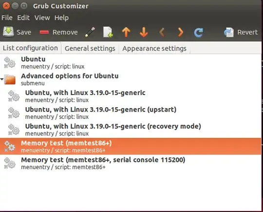

Graphical way :
Install grub-customizer, it will let you manage your grub entry easily:
sudo apt-add-repository ppa:danielrichter2007/grub-customizer
sudo apt-get update
sudo apt-get install grub-customizer
grub customizer
Select the entry you want to delete, click on Remove and when you are done do not forget to click on Save.

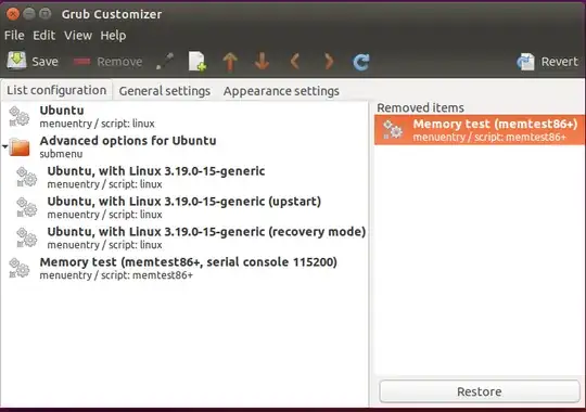

Restoring deleted entries :
If you accidentally deleted the wrong entry grub-customizer include a function to easily restore removed entry :
