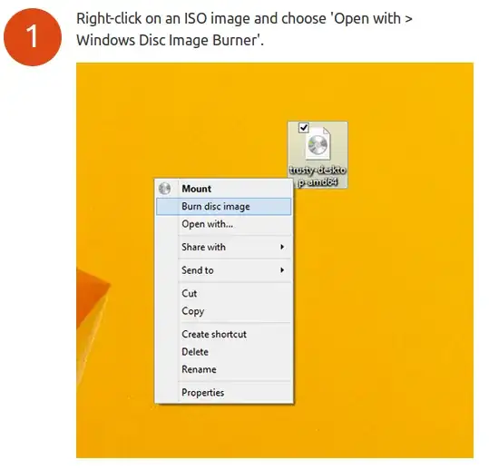

If you need to, download the .iso from here from ubuntu http://www.ubuntu.com/download/desktop and this time just leave the .iso as is and do not compress the file. (You have to right-click on the .iso to burn the Ubuntu installation disk).
If you copy and paste the .iso into the DVD folder and burn it, it will not work.

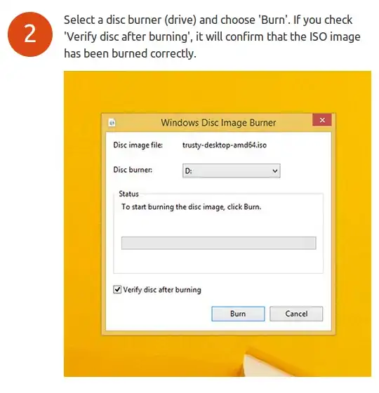

How to burn a DVD using Windows7/8
To install Ubuntu on a computer that currently runs Windows, you need to download the installation file and burn it onto the DVD, which you can then use to install Ubuntu. Once you’ve downloaded the file, closely follow the instructions below to burn your DVD.

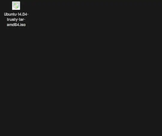

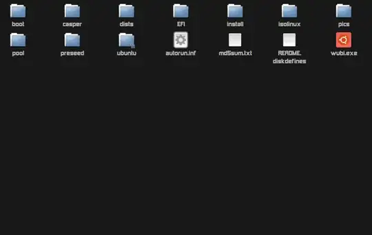

When you are done, the burned DVD should contain a few files and should look something like this
Ubuntu 14.10 contents
If the contents of the burned DVD is the single .iso file like this, you did something wrong.
FAIL

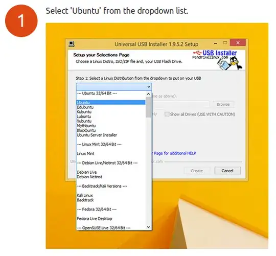

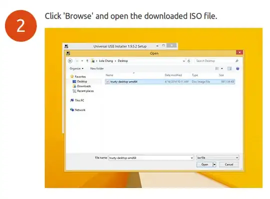

It is usually recommended you use a USB device to install Ubuntu rather than a DVD if your device is capable of selecting a USB drive as a boot device. The BIOS setting for a USB installation is the same as for the DVD; place the USB drive at the top of you list of boot devices to boot first.
You will need to download Universal-USB-Installer-1.9.5.3.exe
enter image description here enter image description here enter image description here
