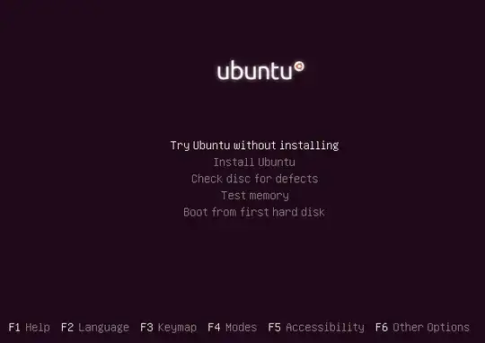

  4. When you see the following screen:
    Ubuntu Boot screen

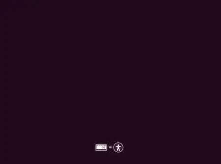

    press any key and you will see this screen:
    Ubuntu Boot - Advanced Options
  5. Press F6 then Esc
    Note: The boot command line is now available for editing and will remain so as long as no pop-up menu is visible.
  6. Leave a space following the "--" and add forcepae.
  7. The command will be executed when Enter is pressed and the "Try Ubuntu" boot sequence will begin.
All the above is completely harmless and will not damage your PC!
