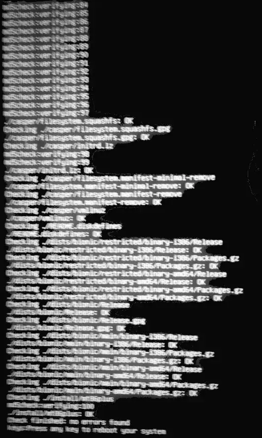

I have followed the given instructions in the next three screens:
1st screen:
GNU GRUB  version 2.02-2ubuntu8.9
setparams 'Check disc for defects'
         set gfxpayload=keep
         linux     /casper/vmlinuz boot=casper integrity-check noapic noacpic quiet splash ---
         initrd    /casper/initrd.lz
The result was:

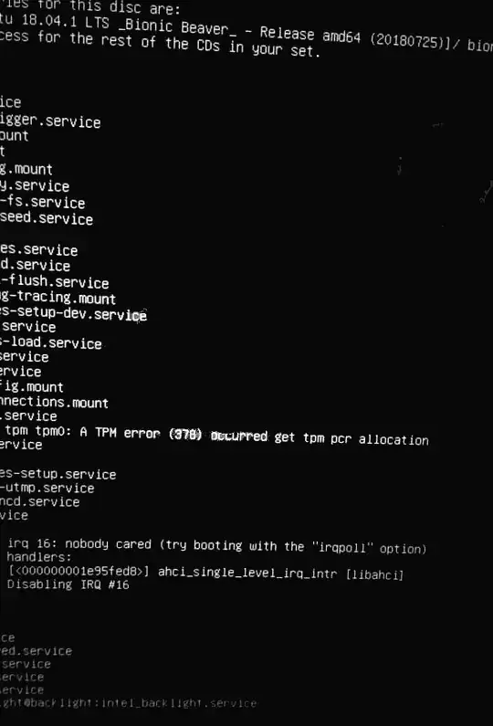

Then, I restarted the computer, enter to windows 10 an do the known steps and I got:
Then the screen freezes.
Supposition: I guess that the UEFI or more generally my laptop does not start the graphical environment to start the trying or installing Ubuntu options. (It's a supposition because I am not well-versed in either BIOS or UEFI.)

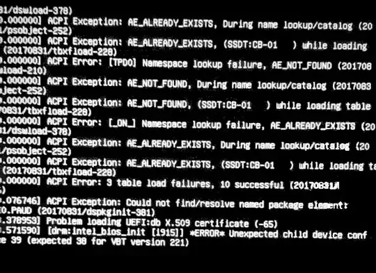

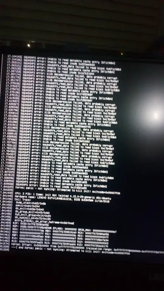

I have tried to install Ubuntu from a DVD, and I got the following errors right after choosing to try or install Ubuntu:

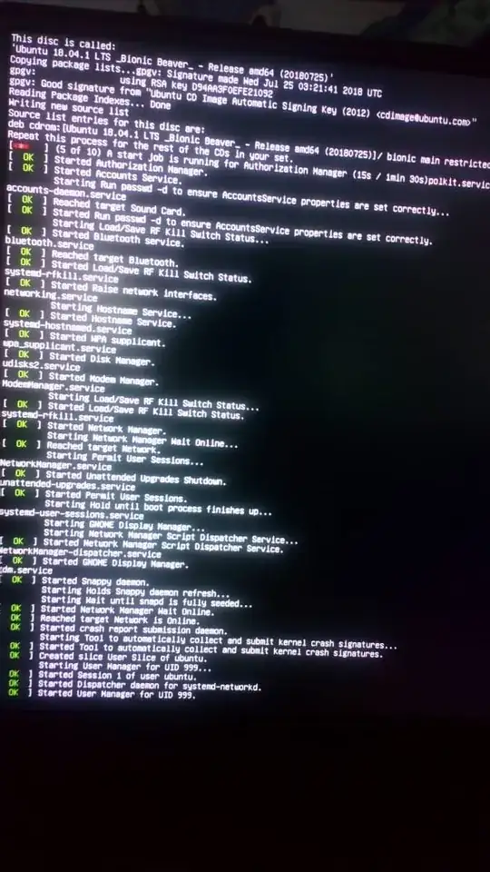

I want to install Ubuntu with dual boot with Windows 10. When I finally made my laptop to read my bootable USB flash (Etcher) I got:
I have spent three days and I do not know what else to do.
I have done:
  1. disable fast boot
  2. disable Intel fast storage
  3. disable secure boot
  4. I have made a partition from windows
  5. enter to the USB from windows option of restarting
  6. I get the UEFI black screen to choose what to do and I get the same screen no matter if a choose to try Ubuntu or to install Ubuntu.

With the sort of errors you initially saw, the first thing to check is the ISO with a hashcheck, and then the media selecting the media check grub menu option. A memory check is the third thing to check. Since you did this, the media is OK, but if interrupts are not handled correctly, the program can get scrambled, resulting in all sorts of random errors. The noapic and nolapic options added to the line starting with "linux" in the grub menu item being booted change the way interrupts are handled, and apparently, allowed the program to complete.
The next problem is a video issue likely caused by proprietary video hardware. Until the proprietary video drivers are installed, adding the word "nomodeset" on the grub linux line allows the video to run, probably at a reduced resolution. If you immediately install the proprietary video drivers (e.g. for Nvidia, run the Software and Updates program, select the Additional Drivers tab, and select the current (tested) driver). If you don't want to do that, you can add the nomodeset word to the grub configuration by editing the /etc/default/grub and adding nomodeset to the line
GRUB_CMDLINE_LINUX_DEFAULT="nomodeset quiet splash"
Then run
sudo update-grub
to update the grub.cfg file, which controls the displayed grub menu.
