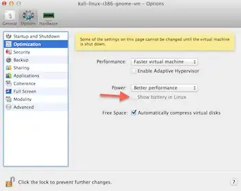

Uncheck the "Show Battery in Linux" as shown in this forum:
https://forums.kali.org/showthread.php?71-Parallels-Desktop-7-Installation-(BUG-Soft-Lockup)&p=3642&viewfull=1#post3642
