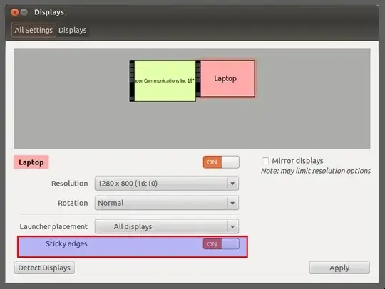

I use Ubuntu 12.04 on a two screen setup. Multiscreen on 12.04 has generally become much better, but there is one thing that really gets on my nerves: there's a mouse magnet of sorts on the middle edge (between the two screens). It's undoubtedly there to make it easier to interact with the launcher on the right screen. But I have enough trust in my mousing skills, the magnet is more annoying than helpful in my case. Can I disable it somehow?

There is a setting for it in Displays:
You may still get the behaviour if you have a launcher on the right monitor, so use the "Launcher Placement" option to select having your launcher on only the left screen. The stickyness between the screens is required for it to be easy to retrieve the launcher there.
You might need to log out and back in (or restart) for the changes to take effect.

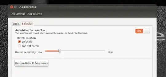

I personally thought it could be a wrong design in an extended desktop where in the middle of the desktop, a launcher is present. Yet, notice that the launcher has new settings :
The reveal sensitivity allows you to adjust how much the launcher is sensitive to your mouse crossing. The higher, the more you have to push the mouse against the launcher to reveal it. While auto-hide is activated, and about 27 % of reveal sensitivity, you can surf your mouse from the left external monitor to the right one or the opposite, easily without accidently revealing the launcher. Check the poll, if you want to vote for this option.
