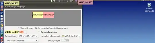

I tried installing kubuntu-desktop for RDP. However it changed my Unity desktop a bit and I didn't know it was loading masses of other apps.
So I removed it and it left the desktop changes including too large icons and text. When I went to change the size, my mouse "jumped" and set it to 2x size. Before I could click it and resize it smaller again, the whole display changed and I was left with only a fraction of my desktop on the two displays.
What you see in the image below is actually a screenshot of both monitors. You can see the center between the monitors where the task bars are different sizes. The Displays window actually crosses the two monitors.
Desktop Screenshot
As you can see, I can't reach the control to change the setting in Displays.
I guess I need to make the change in the terminal.
Any suggestions?

Press ALT and hold it and try to move the window upwards so that you can reach the controls.
Harris
  • 2,588
reinstalling unity will do it for you.
you can do it by going to a terminal by pressing ctrl+alt+T then copy past this to it.
sudo apt-get update
sudo apt-get install --reinstall ubuntu-desktop
sudo apt-get install --reinstall unity
this should solve your problem because KDE have broken your unity,
