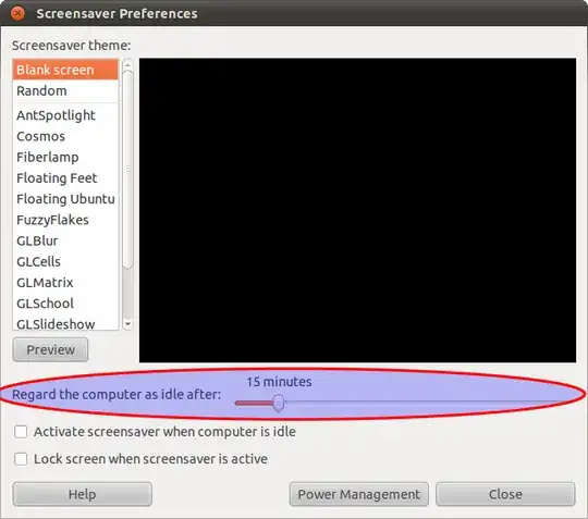

This is the "Regard computer as idle after" slider on System → Preferences → Screensaver:
alt text
Or the gconf key /apps/gnome-power-manager/backlight/idle_dim_time, which you can set thusly:
gconftool --type int --set /apps/gnome-power-manager/backlight/idle_dim_time 120
which will set the timeout to 120 seconds.
