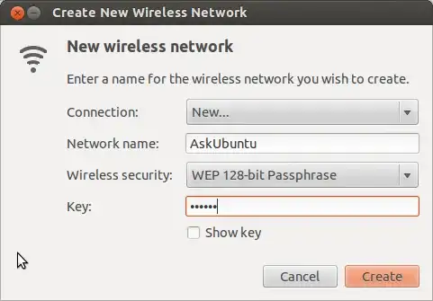

  1. Click the network icon
  2. Select "Create wireless network"
  3. Choose a name, encryption type and password
  4. Click create
  5. Make sure you're connected to the internet.
10
Create Wireless (Ad-Hoc) Network
First make sure that your wireless network is enabled by hardware switch.
Click the network menu (located in panel, top right in Unity). Select Create New Wireless Network from the menu.
Wireless_with_password
Enter a Network name and password. You can also create a network without any password. For that change wireless security to None.
Wireless_without_password
After you click on Create, a new wireless network would be created. Note that if you were already connected with some wireless network, that connection would be disconnected.

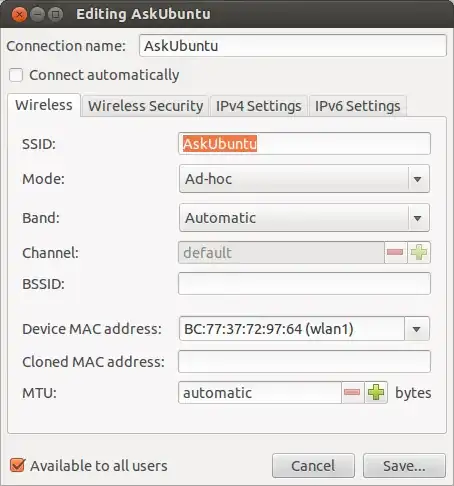

Edit Wireless Network
In case you want to edit an earlier created network (like if you want to change the password), go to the network menu again and select Edit Connections...
Go to the Wireless tab and double click the network you want to edit.
Wireless Settings
From here, you can change the Network Name, Security Settings and passphrase. You can also modify more advanced settings like the Band and Channel, IPv4 and IPv6, MAC addresses, Basic SSID (BSSID), MTU, Automatic Connection (Creation), and the Availability of this to other users on your machine.

In case of sharing to an Android mobile device from a laptop with Ubuntu 16.04
Create a new Wifi network. Then edit it and change the type from "Ad-Hoc" to access point.
