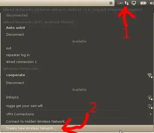

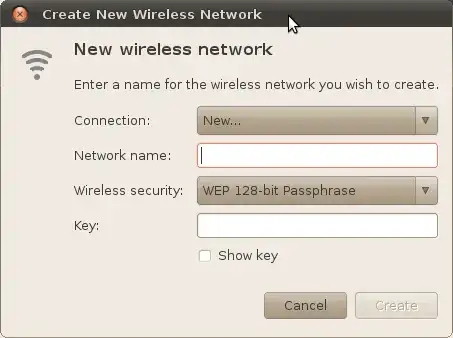

For wifi Ad-Hoc Click Network Manager then Create New wireless network And in window choose wep and enter 5 or 13 character long password and click ok. That will make your laptop as ad-hoc router sharing Internet connection if it has any. First steps Enter name and passw
