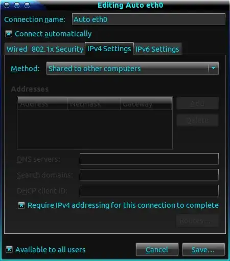

you need to go into network manager and change your ip4 settings to shared to other computers
here is the other method using ip tables
this will set the ip of your ethernet card
sudo ip addr add 192.168.1.1/24 dev eth0
and this will configure the nat
sudo iptables -A FORWARD -o wlan0 -i eth0 -s 192.168.1.0/24 -m conntrack --ctstate NEW -j ACCEPT
sudo iptables -A FORWARD -m conntrack --ctstate ESTABLISHED,RELATED -j ACCEPT
sudo iptables -A POSTROUTING -t nat -j MASQUERADE
if the connection you are using for internet is different from wlan0 change that so if you are using mobile broadband it will most likely be ppp0
when you have done that you can save the settings by doing
sudo iptables-save > filename
and to reload the settings
iptables-restore < filename
the restore is needed because after a reboot iptables will forget what the settings entered above if you want it to load every time just put the restore line in /etc/rc.local
