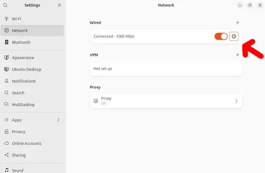

Open Settings -> Network.
Click the cog under Wired:

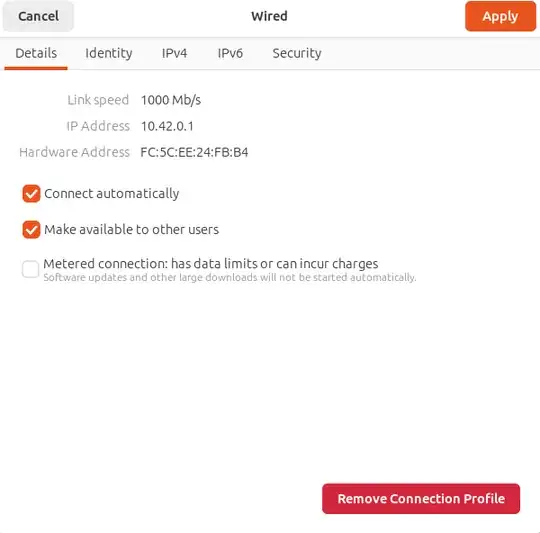

I don't think I changed anything here:

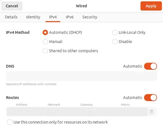

Select "Shared to other computers" (TODO how to do this from CLI? https://unix.stackexchange.com/questions/243408/share-wlan-connection-to-ethernet-using-command-line )
And then "Apply".
