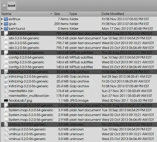

I'm going to guess that Update Manager is trying to load a new kernel in /boot and there's not enough room, so we can free up space by removing older kernels.
Firstly and foremost, please be careful.
Let's look at what's in the /boot partition - I'll use Nautilus as Super User from my computer to provide an example.
lkristie@TinMan:~$ sudo nautilus
[sudo] password for lkristie:
This is the procedure I follow when I need space for new kernels.
Open /boot when Nautilus comes up (screenshot below).
Note the tagged objects are all of the same version - delete them; I'd recommend this: free up the disk space you need and that's it.
If you're tempted to do some housekeeping here, understand the impact of whatever it is you decide to do and - if you're not sure - do the required reading before taking any action.
