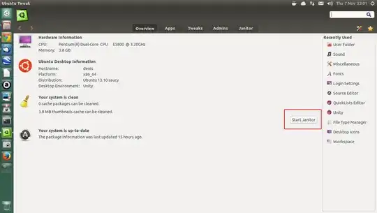

Once you have installed Ubuntu Tweak, open the application up.
2 - Click on Start Janitor

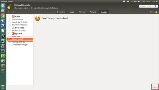

Select Old Kernel & then click Clean
Enter your password when asked, press enter and now only the old Linux Kernels will be removed.
