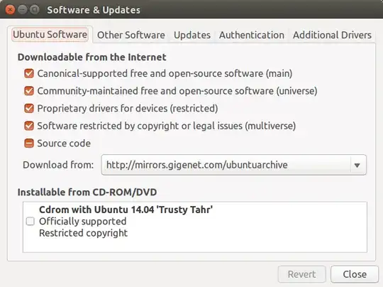

  2. If searching in the Software Center does not work, or you wish to do it yourself, you can do this with Software and Updates. Search for it using the dash, click on it and you will get window like this enter image description here
The second box down needs to be checked to allow universe sources. Check the box, enter your password in the box that pops up. This will enable the source. When you close the Software and Updates window, it will ask you if you want to reload you software sources.
Answer Yes and your software sources will update, you will then be able to find and install solaar in the software center.
