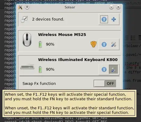

Solaar is a graphical utility that has the ability to configure the Fn key functionality on newer devices:
Solaar screenshot with Fn function swap configuration
Since Ubuntu 15.04 (Vivid), Solaar can be installed from the repositories (sudo apt-get install solaar). After installation, you can search for Solaar in the applications menu and start it from there.
A command line interface is also available. Example usage:
$ solaar show
  2: Wireless Illuminated Keyboard K800
$ solaar config 2
fn-swap = False
$ solaar config 2 fn-swap on
fn-swap = True
Note that these settings are not persistent, you will loose it after reboot. This may change in future versions of Solaar.
