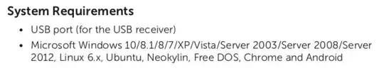

According to this 2016 PDF for KM636, which uses the Dell Universal Receiver, Ubuntu is supported:
KM636 PDF System requirements

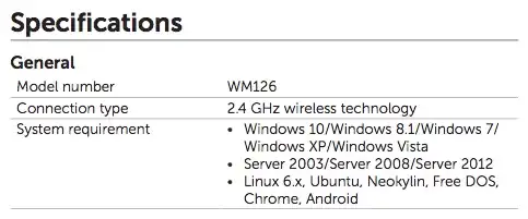

The same is stated in this 2015 PDF for the WM126, which also uses the Dell Universal Receiver:
WM126 PDF System requirements

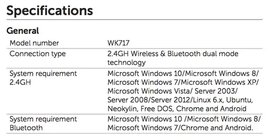

Interestingly, the 2016 PDF for the WK717 suggests that Ubuntu is supported for the 2.4 GHz connection, but not for the "dual-mode" Bluetooth connection:
WK717 PDF System requirements
