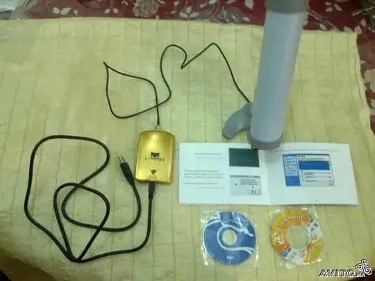

The antenna is so called "long range" and is attached to a USB wireless adapter via coax cable, while USB cable comes from adapter to the PC.
It looks like this
