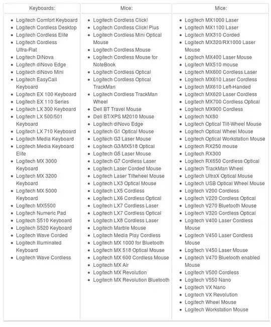

You can have a look at HIDPOINT which from the looks of it are working on Logitech hardware.
"HIDPoint can be considered as a Linux version of Logitech’s or Microsoft’s Keyboard and Mouse configuration software."

From THIS blog which dates back 2 years ago I found the following list of supported hardware:
Since this was 2 years ago their might be more devices supported. The last update they did to the HIDPOINT software was in February 15, 2012 Version 2.1.1.172. So this means they are still working on implementing more Logitech & Microsoft devices into Linux. I don't have this mouse yet, but I already made my mind about buying this one and the anywhere mx mouse.
