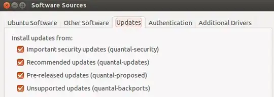

You only need to update the system if you are using 12.04 or 12.10.
I have had several questions related to the Anywhere Mouse and the Touch Mouse M600
Is Logitech's Unifying receiver supported?
Can I use the Logitech Touch Mouse M600?
I even participated in this launchpad bug: https://bugs.launchpad.net/linux/+bug/958174 where several solutions like:
sudo modprobe -r hid_logitech_dj
sudo modprobe hid_logitech_dj
were mentioned but at the end, updating the system fixed all issues with both mouses.
There is even a askubuntu answer about it here: Logitech M515 does not work after upgrade to 12.04
But for all 4 computers I tested this, the solution was to activate all repositories by default not activated (universe, multiverse, proposed, backport), do an update and upgrade. Reboot and the mouse should work out of the box perfectly.
If by chance doing this does not fix the problem, then doing a diagnostic to it will help, for example:

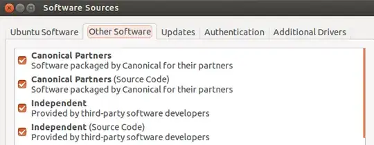

This has been tested in USB 2.0 and 3.0 ports. To make sure (at least for most users) that this work, ALL repositories have to be activated. Like the following 3 images:
Here we see main, universe, restricted and multiverse activated. I also changed the server from my country to MAIN
Here I activated since they were off, the Canonical and 3rd party repositories.
Here wee see proposed and backports activated (Beside security and updates).
After all that I did a sudo apt-get update && sudo apt-get upgrade. Rebooted the PC and done.
