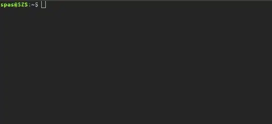

To to resolve a host, just add it to /etc/hosts, like the example below.
Animated example
Use ctrl+o to save the edits and ctrl+x to exit from Nano. Here you are and screenshot example.
In this example is assumed that the hostname (SZS in this case) is correct, but it is not bound to the server's IP address via server's hosts file.
To resolve this issue you must find (or set) your hostname and insert next line into /etc/host:
127.0.1.1    your-hostname
The commands used in the example are:
cat /etc/hostname      # the command 'cat' will print the content of '/etc/hostname' file
hostname               # without arguments, this command will do the same as above command
cat /etc/hosts         # will print the content of '/etc/hosts' file
sudo nano /etc/hosts   # 'nano' text editor will open '/etc/hosts' as root
