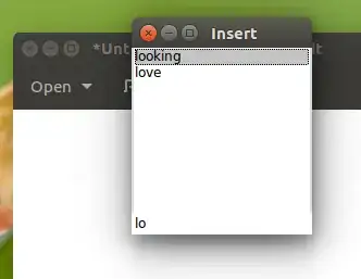

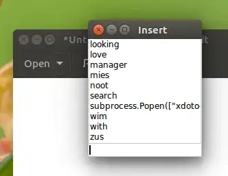

  1. Press a shortcut, a small window appears:

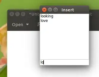

  2. Type one or more characters to limit the selection:

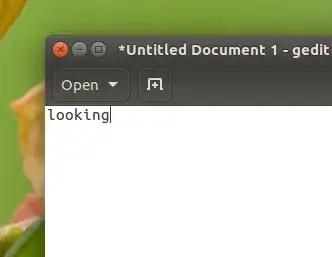

  3. Double click on the string you'd like to insert:
  4. The string is pasted in your document, the window closes itself:

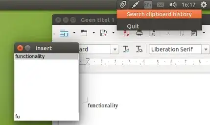

2. Indicator version (single-script, simple setup) with optional keyboard shortcut, also pasting correctly in gnome-terminal

    to start the indicator + background script. Choose Search clipboard history from the menu to call the little window.
