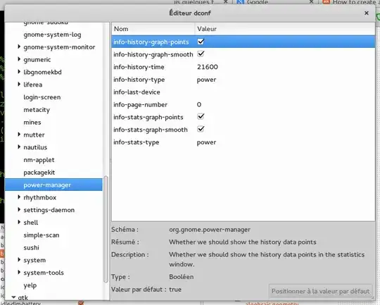

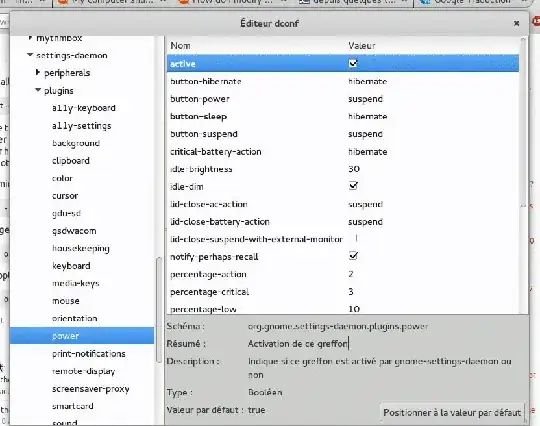

I have a little but annoying problem with my laptop. For quite some time my Asus K53SD (Xubuntu last LTS) 64 bits is shutting down without any demand when it have about 50% battery. I checked the power parameters (which I didn't touch) even if I see nothing wrong:
Perhaps, the system overvalue the real capacity of my battery?
Note: When I reboot my computer it shuts down immediately.
