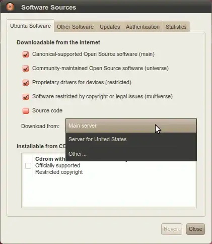

In a Desktop environment I would select the main mirror like this:
Software Sources
But how do I do that from the terminal as I don't have a graphical environment installed!
