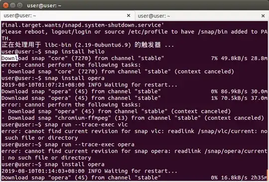

When I try to install anything using snap, I found out that the download speed is very slow. As shown in the screenshot, it is about 20 kb/s:
How can I install a snap fast?

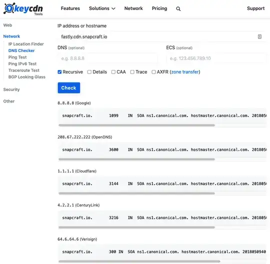

Use dns checker service on the web to get the nearest ip of fastly.cdn.snapcraft.io, in my case it went up from 25KB/s to 25MB/s
84.200.69.80 (DNS.WATCH - DE)
