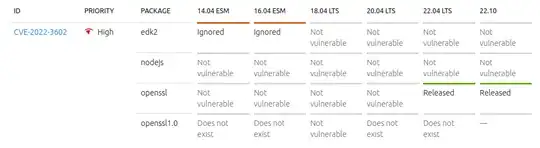

Third, let's look at CVE-2022-3602 in the Ubuntu CVE Tracker:
Ubuntu CVE Tracker for CVE 2022-3786
This tells us a couple of important things:
  1. The Ubuntu Security Team is already tracking the issue.
  2. The only package affected is openssl.
  3. A patched package has already been released.

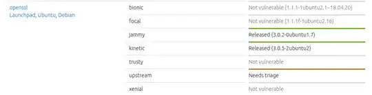

Fourth, let's dig a little deeper by looking at package details the tracker:
Now we know the exact version numbers of openssl packages that are patched and secure.
  • Reminder: It's patched, so the version number is NOT 3.0.7. But it's still secure; that CVE has been mitigated.
