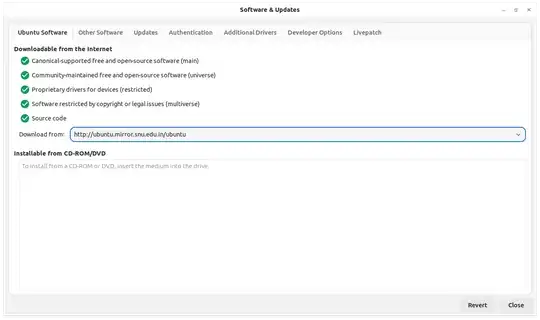

To change the mirror server:
First, open the "Software and Updates" app from the Application launcher or simply run software-properties-gtk in the terminal.
After opening the application you will see 6 tabs and in each tab, a few options: enter image description here
Go to the "Ubuntu Software" tab. (the first one)

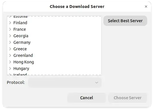

Then there you will see a bunch of options. There would be a drop-down menu there saying "Download from", Click on that.
It will look like this:
From there you could select "Main server" or the server you prefer. If you want to select a server in a country then you can go to "Other..." Tab and from there select the preferred server.
I would prefer clicking on "Select the best server".
