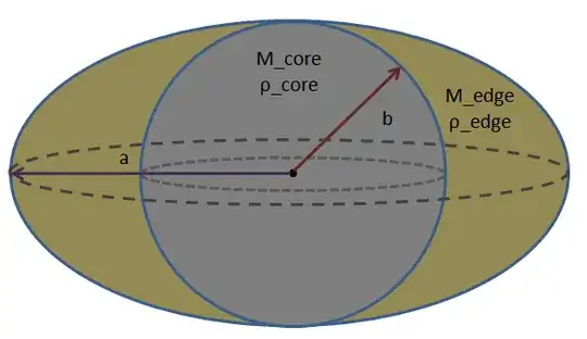

Nonuniform interior: primitive model
The previous solution is both interior and exterior for a rotating uniform ellipsoid, and it is exact in r, it is only leading order in the deviation from spherical symmetry. So it immediately extends to give the shape of the Earth for a nonuniform interior mass distribution. The estimate with a uniform density is surprisingly good, and this is because there are competing effects largely cancelling out the correction for non-uniform density.
The two competing effects are: 1. the interior distribution is more elliptical than the surface, because the interior solution feels all the surrounding elliptical Earth deforming it, with extra density deforming it more. 2. The ellipticity of the interior is suppressed by the $1/r^3$ falloff of the quadrupole solution of Laplace's equation, which is $1/r^2$ faster than the usual potential. So although the interior is somewhat more deformed, the falloff more than compensates, and the effect of the interior extra density is to make the Earth more spherical, although not by much.
These competing effects are what shift the correction factor from 2.5 to 2, which is actually quite small considering that the interior of the Earth is extremely nonuniform, with the center more than three times as dense as the outer parts.
The exact solution is a little complicated, so I will start with a dopey model. This assumes that the Earth is a uniform ellipsoid of mass M and ellipticity parameter $\delta$, plus a point source in the middle (or a sphere, it doesn't matter), accounting for the extra mass in the interior, of mass M'. The interior potential is given by superposition. With the centrifugal potential:

In this answer, I will present a framework to use, and then I will frame the prior answers within that framework. Let me sum up the values we have here. I'll use the same notation (as best as possible) as everyone else and Wikipedia for an oblate spheroid where $a$ is the large, equatorial, radius.
  • Mark1, method in the question, $2 (a-b) = 21.6 km$
  • Mark2, method in the answer, past answer times 5/2 for $2 (a-b) = 54.0 km$
Here is my approach:
The mass of the earth can be taken a combination of two shapes, an inner sphere with radius $b$ and an edge volume, which is the oblate spheroid minus the inner sphere. The Earth has a certain average density defined by $\rho = M/V$, but this can be divided up into two different type of materials, the core, and the crust. The total mass requirement will then require that $M = V_{core} \rho_{core} + V_{edge} \rho_{edge}$, while the average density of the Earth requires $V = V_{core} + V_{edge}$, constraining $a$ and $b$ by one degree of freedom. When writing a code we can say that $a$ always implies $b$ according to $b=3V/(4 \pi a^2)$, the crust density also can be taken to imply the core density. Then the equipotential surface constraint dockets another degree of freedom, which can be used to iteratively find the value of $a$. Illustration:
spheres
The potential from the inner sphere is easy. I'll write it for a point on the equator and on the pole, combined with the other potentials.
$$U_a = G \frac{M_{core}}{a} + U_{a,edge} + \frac{1}{2} \omega^2 a^2$$ $$U_b = G \frac{M_{core}}{b} + U_{b,edge}$$
Obviously, the hard part is calculating the potential from the ridiculously irregular edge shape. Before that, however, it's important to think of the physical implications of looking at the problem this way. To begin with, what are relevant densities relevant to Earth? Here is the average density, and then the density within about 0 to 200 km of the surface.
$$rho_{Earth} = 5520. \frac{kg}{m^3}$$ $$rho_{crust} = 3400. \frac{kg}{m^3}$$
When we actually solve the problem, we will specify the crust density, and then that will imply a density of the core sphere. Is this method accurate? No. The main thing it misses is that the center sphere is not a spherically symmetric distribution of matter. The densities will theoretically stratify according to constant potential lines. In other words, if there were a high-density core of the Earth, it would also be an oblate spheroid. Because of that reason, introducing the inner sphere does miss some detail, but this model could still be pretty good.
Implementing this is a little tricky, as others have pointed out, but focusing the calculations on the edge volume helps a great deal. I also used a Monte Carlo method, but subtracted out the core volume. That is to say, I shot points randomly into the edge volume as efficiently as reasonable. In order to do this I used a weighted method, and it seems to have worked out okay. With 5 million iterations I found random variations in the calculation of the potential at $a$ to have a standard deviation of about $15 m$ of gravitational potential equivalent and around $2 m$ of gravitational potential equivalent at $b$. The reason for the higher deviation at $a$ is because it has more mass close to it, and the sampling was unbiased in the yz-plane for calculations of the $a$ potential and unbiased in the xy-plane for calculations of the $b$ potential. Anyway, as I iterated on the $a$ value, I set a tolerance for $100 m$, because this should be considerably higher than the statistical variation and it's good enough for calculation of the bulge. To recap, this is my method:
For calculation of potential at $a$
  • Sample two random values for the $y$ and $z$ values between $0$ and $a$
  • If these two values lie outside of the ellipse of $\frac{y^2}{a^2}+\frac{z^2}{b^2}<1$ then sample two new values and try again (gives something like a 30% loss of efficiency)
  • Sample an x-value between the surface of the inner sphere and the outer spheroid. If the (y,z) pair doesn't fall within the inner sphere, sample between $0$ and the outer spheroid surface.
  • Tally the potential between the sampled (x,y,z) point and (a,0,0), using the M_edge mass
  • Repeat between (-x,y,z) and (a,0,0)
  • Tally the weight for this sample as the distance between the two surfaces times two.
  • The potential at (a,0,0) is then the total tallied potential divided by the total tallied weight.
  • Repeat a similar method to find the potential at (0,0,b)
  • Numerically root find to satisfy the equipotential condition discussed above.
I did this, and for the different values of the crust density, I got the following.
  • $\rho_{crust} = 0$, implying gravitational field is insensitive to flatness, gets $2(a-b)= 21.8 \pm 0.1 km$
  • $\rho_{crust} = 3400. \frac{kg}{m^3}$, a reasonable value for the crust density, gets $2(a-b) = 34.7 \pm 0.1 km$
  • $\rho_{crust} = 5520. \frac{kg}{m^3}$, a fully homogenous density of the Earth gets $2(a-b) = 54.0 \pm 0.1 km$
I thought these are good results because the first and last of them come close to the prior answers within numerical error and the reasonable value for crust density gets closer to the real value of $42 km$.
If anyone is interested, I can look into putting the code for this on github or something similar. Otherwise, it's a little longer than the others posted here, so for now I'll avoid cluttering this space.
