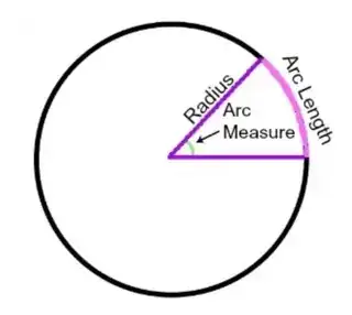

The second part I don't understand is equation $(3)$ marked blue. I'm unsure as to what the angle $R_{\text{arcsec}}=960''$ corresponds to. Is it an angle within the object, such as: arclength
which was obtained from this website or is it an angle like: angularsize
from this website?

The second part is simple: The author first finds how much of an angle (in degrees) do the Sun itself (or, the radius of it) is seen like from Earth (which is 1 AU far from the Sun). This is the $\theta$ in the last image you linked. Then he just leaps to the conclusion that if $R$ is seen as $\theta$ degrees, $\Delta R$ must be seen as $\theta\cdot(\Delta R/R)$ degrees, and that is the last line of his solution.
