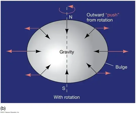

good explanation here, image source

To quickly recap, as the earth spins there is an outward centrifugal force, the further away from the axis of rotation the greater the force/acceleration. Since the earth spins arounds it's pole, in other words the axis of rotation goes through the poles, they don't really experience any centrifugal force. The equator experiences the most centrifugal force. Because of this centrifugal force the earth and oceans bulge around the center. Gravity decreases by $1/R^2$ and water is much less dense than the iron and molten rock below the very thin crust of the earth. also see the image below:
Keep in mind I might have simplified a few things for clarities sake.
