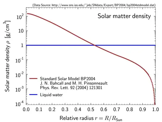

I) In this answer we will only discuss the equilibrium shape. Recall that when we discussed the shape of Earth in this Phys.SE post, the gravitational quadrupole moment was important. Unlike the Earth, from a surface perspective, it is a very good approximation to assume that all the mass of the Sun sits in the center, cf. below graph.
Moreover, the Newton's shell theorem helps out here. We conclude that it is enough to consider the gravitational monopole field
