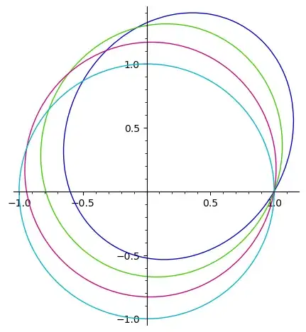

Here are the same ellipses, but rotated about the focus so that they all pass through $(1, 0)$.
Rotated ellipses
At that point, $r=a=1$. From vis-viva, all the orbits pass through that point with the same speed, so they all have the same specific kinetic energy there, and of course they have the same specific potential energy there because they're the same distance from the Sun.
