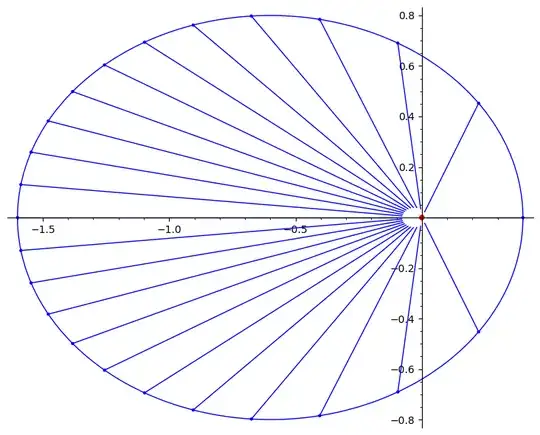

Kepler discovered that an orbiting body "sweeps out" equal areas in equal times. Newton showed that's because angular momentum is conserved in a central potential field. Here's a diagram for an orbit of eccentricity $e=3/5$. The dots on the ellipse are plotted at equal time steps of $T/24$, so each sector has equal area.
Kepler area law
Near perigee the points on the orbit are spread out, and near apogee they are bunched closer together.
