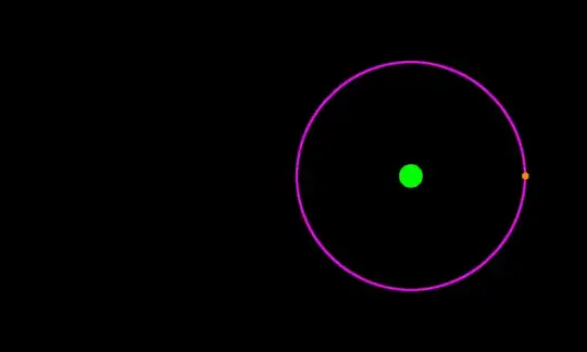

Here's the start of the scenario (The spacecraft is travelling counter-clockwise from this POV): A green planet, an orange spacecraft, and a magenta circular orbit line.

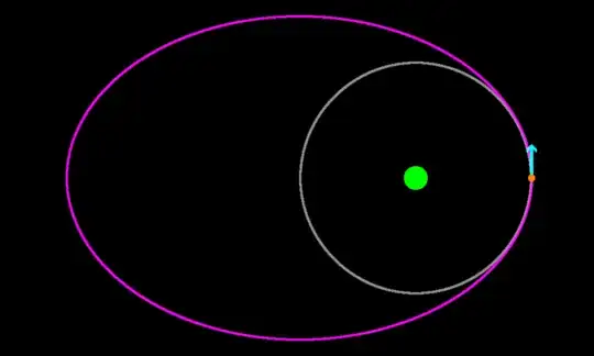

Then, the spacecraft thrusts prograde, changing the orbit into an elliptical one: The spacecraft now has a highly elliptical orbit.

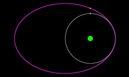

As you can see, when the spacecraft has traveled 90° forward in its orbit, its in a very different state than it was when the scenario started. It's further away from the planet, moving more slowly, and moving away from the planet at an angle. A diagram of where the space ship would be after 90°, compared to where it would be if it hadn't thrusted.

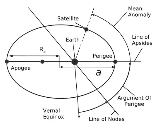

Let's consider the elliptical orbit (following the initial burn). The foci of the orbit (including Earth) lie on a line connecting the perigee and apogee (the line of apsides). This is indeed a line of symmetry for the ellipse. However, that does not mean that the Earth is at the center of the ellipse. See the image attached (from http://dx.doi.org/10.1109/MILCOM.2008.4753110).
Elliptical orbit diagram
The source of confusion may be indicated by the incorrect statement in the question that the apogee to perigee is a quarter of the orbit. This is not the case, that is always going to be half the orbit (both in terms of distance travelled and time).
