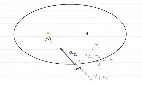

Suppose we have a central mass $M$ and a smaller mass $m$ orbiting around the central mass in an ellipse: enter image description here The other point is the other focus. We know that elliptical orbits have the central mass in one of the two foci of the ellipse, I put the other one to emphasize this fact.

However for the ellipse, how can we conclude that the velocity needs to be $\sqrt{\frac{GM}{r}}$ at any point? We can't make the assumption that $a_c = \frac{v^2}{r}$ because we are no longer considering uniform circular motion. What can be done?
